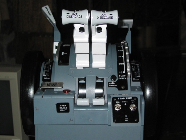

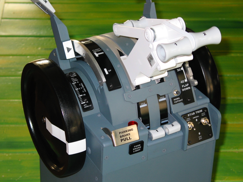

Like those I built...
If you drop a look on the throttle on my site
http://www.sim-737ng.com/throttle/throttle.htm
you will notice I built this new model... Unfortunately it is not possible to modify these 200 version exactly like the real one 737-800... But it will be worthy to have real one in my sim...
Once more thank you Jonsey...
Al
Al

Re: Boeing 737NG simulator seeking pilot...
Ouuuuppssss sorry...!
You will see better the buttons on that photo...
Al
Al

rightseatwonder
- Rank 6
- Posts: 406
- Joined: Sun Feb 22, 2004 7:21 am
- Location: M.78 FL410
alphatango
- Posts: 117
- Joined: Mon Nov 17, 2008 7:47 am
- Location: Ville de Quebec
Yes and this is working actually on my sim...
If you visit my site you will see all details on the built.
Al
Al
- Throttle setup (10).jpg (86.37 KiB) Viewed 3468 times
- Flaps details (15).jpg (79.19 KiB) Viewed 3468 times
- Flaps (8).jpg (77.25 KiB) Viewed 3468 times
Jastapilot
- Posts: 832
dude, that's incredible! One thing to add, since you seem to be into the finer details, is there's a kind of guard switch on the stab trim switches. I can get a picture if that helps.

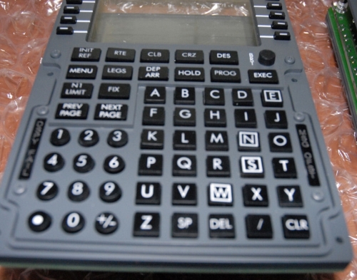

Once more, a new question for you... lucky real pilots...
I am looking to buy 2 real FMC's panels for my sim...
I have the choice between 2 different setups. The first is with the N1 LIMIT button the second with NAV/RAD button in place of the N1 button.
My question... Does it exist in real with this NAV/RAD button??????
So, waiting for your answer...
Al
the Westjet NG's have the N1 limit button!
