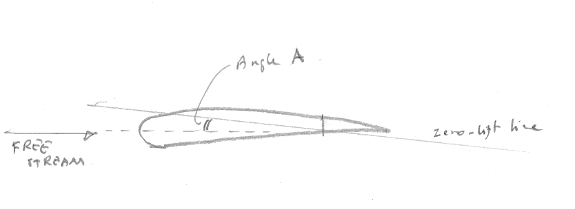

Alright, ladies and gentlemen - a basic explanation of how an aileron works. Nothing here about angle of attack, nothing here about vorticity, spanwise distribution of circulation, and not even any equations.
Let's begin:
Here's a wing section. It has a moderate camber, and I've drawn on the picture the chord line. I've also drawn on the picture a line I'm going to call the zero-lift line. If air flows past this wing section parallel to that line, no lift is generated. You'll notice that because of the camber, the zero-lift line makes a slight angle with the chord line.
Let's call it Wing 1.

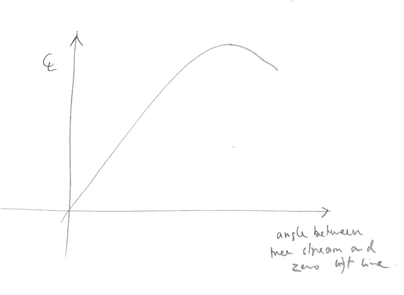

Exhibit 2 is another wing section. Let's call it Wing 2. It's solid, like Wing 1, and it's a similar shape except that the trailing portion has been bent downwards by 10 degrees or so. because of this bend the Wing 2 as a whole has a lot more camber than Wing 1. I've drawn the chord line, and I've drawn the zero-lift line. Because of the extra camber the zero-lift line makes a much bigger angle to the chord line than Wing 1.
Here's a graph of the coefficient of lift of Wing 2, plotted against the angle the free-stream flow makes to the zero lift line. It's very similar to the same graph for Wing 1 - there are some differences at the top, near the critical angle of attack, because it has a different shape, and extra camber. But one of the lessons of all those NACA curves is that for the most part, the shape of the wing has only a very slight effect on the shape of the Cl curve. Certainly nothing you'd notice in a hand-drawn sketch like this.

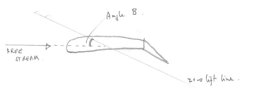

Here's a new wing - let's call it Wing 3. It's the same shape as Wing 1 except the rear portion is hinged so it can swing up and down. Here's the wing with the rear portion straight, in flight. I've drawn the free stream direction, the zero-lift line, and the angle between them (Angle A). If I want to know the coefficient of lift for that configuration I can look it up on the graph I posted earlier.
And here it is again, with the hinged part in the down position.
By curious coincidence it now has exactly the same shape as Wing 2! I've drawn on the picture the free stream direction, and the new zero-lift line (which is the same as the zero-lift line for Wing 2 as is has the same shape) and I've marked the angle between them as Angle B. I can look up the new coefficient of lift for this configuration on the Cl graph for Wing 2.

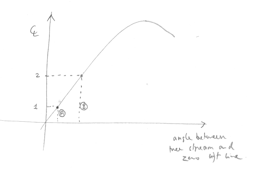

Let's superimpose the CL graphs for Wings 1 and 2, and simultaneously mark on them the angles A and B, to see how the coefficient of lift changes for Wing 3 as I lower the rear hinged portion. The two graphs are so similar (especially when sketched by hand) that there's no real difference between them!
And lo, there, in graphic detail is the difference in the Cl between the two configurations of the wing. If the Cl increases when I lower the rear section of the wing, then the lift increases. If that were the outboard part of a long wing then I'd generate a rolling moment and able to manoeuvre the aircraft about it's longitudinal axis.

Interesting, that difference between angle A and B. I wonder what somebody might call that.

Re: Angle of attack in a climbing turn
I don't think he's even allowing himself to consider separate sections of the wing can have differing angles of attack .... because it would work great in describing the wing
No it wouldn't. You'd have a lift curve that varied at every station, even where the wing section is the same NACA airfoil - a continuum of different lift curves, so to speak. Even an idiot can see the situation is more simply described by a single lift curve and an angle of attack that varies spanwise. Good science is about making complex things simple. Not about making simple things complex.
While the Wright Brothers invented wing-warping, literally twisting the wing-tips to change the lift distribution, is he seriously trying to tell me that, by any measure, the AoA of the wingtips isn't changed? Or do we allow that as a change in AoA, yet suddenly because I hinge the rear section of the wing that section instead of twisting it, that doesn't change change AoA? If so, these are distinctions without merit, and I dismiss them.
Trematode
Posts: 235
Joined: Thu Apr 28, 2011 2:46 pm
Post by Trematode »
But that's exactly why an aircraft designer or aerodynamicist might use his definition for certain tasks.
All the changes along the span are expressed as a sum total coefficient of lift, and if you plot it next to alpha, you can see exactly how CL is affected by changes in AoA, and you can plug that into the lift equation.
It's making a complex wing a simple curve.
But again, that does not tell the whole story, and is the reason I am taking issue with what he's saying. It's not that I disagree with either of you -- I'm saying you can think of it both ways.
In his version, a change in aileron deflection, creates a change to the C of L curve. Same thing would happen with flap deployment. If he wants to think of it that way, the AoA of the entire wing doesn't change -- just the shape and position of the CL curve.
What I am saying he's missing, that is probably more important to a student, is that the CL curve changes precicely because individual sections of the wing are changed -- their camber, and angles of incidence (and therefore AoA) are altered. We both know it, and I suspect he knows it as well -- it's just that his restrictive definition of AoA (which he says can only relate to the entire span) doesn't allow him to readily acknowledge it.
dr.aero
Posts: 272
Joined: Sat Apr 30, 2011 3:08 pm
Post by dr.aero »
No, it is not! That is representative of the level of ignorance about science in this thread.
You seriously think I don't know what affects the CL? Wow. I love how you call my definition of AoA "restrictive" too.
I think I'll tip my hat, it's becoming worthless to continue.
Cheers!
