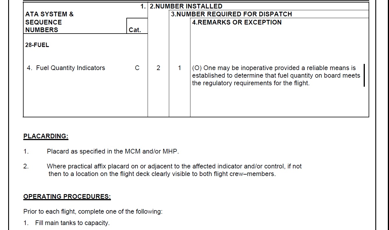

We can operate with 1 U/S, but if both quit, we're grounded.photofly wrote:Does anyone know of an aircraft where completely inoperative fuel gauges are MEL-able?Doc wrote:Otherwise, most fuel indication problems would be in your MEL
- fuel_mel.jpg (180.78 KiB) Viewed 2362 times
