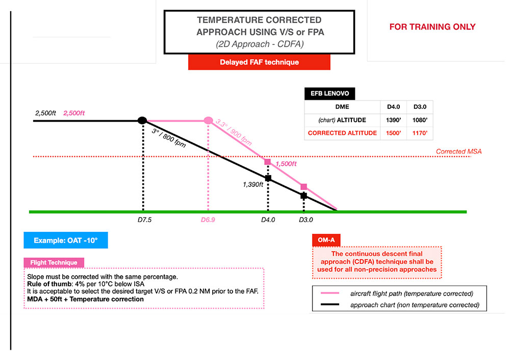

Cliff Jumper wrote: Mon Nov 25, 2019 7:56 am I don't feel like the fact that they didn't have this available was 'damning' to the crew. Or, are you suggesting that they should have pulled out the calculators and created a Alt/Dis crosscheck chart from scratch, using 3.5 degrees?
They absolutely did have it available, the Jepp plate - as Eric pointed out - very much does have published distances and altitudes every mile. As you observed it wasn't much use because they weren't flying the VDA as charted (3.5 degrees vs 3.08 degrees). So yeah, damning.
I get they may have had their reasons to select a higher than charted angle, maybe they thought they had initiated descent late and didn't want to be high - whatever. But if you're going to do that, ie "intercept from above" you better have some other way of knowing if you're high/low/on profile, or trending towards/away from it. Only way to do that on this particular approach is distance versus altitude.
The statement at the bottom of the image kind of blows my mind.
And while I'm pretty sure you were being sarcastic about calculators and creating a chart, perhaps someone can explain how using your own mental math to crosscheck your aircraft position is such a bad idea? On EVERY approach, let alone a NP?
Agreed that ultimately, it was busting MDA without proper visual reference that sealed the deal.

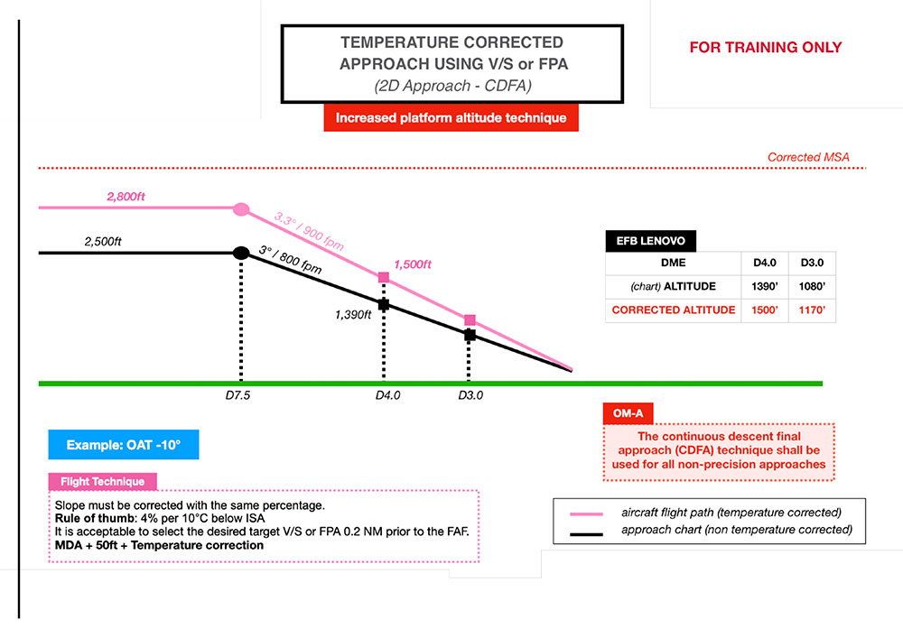

The modified VDA was a company SOP for cold weather ops. The SOP required the crew to calculate a new FAF crossing height and new MDA. Then they needed to calculate an FPA to compensate for these corrections. The SOP did not require them to recalculate the altitude crosscheck heights. Also, even if they had been doing cross checks, the SOP did not allow them to make an FPA correction once inside the FAF.

complexintentions wrote: Mon Nov 25, 2019 10:39 am They absolutely did have it available, the Jepp plate - as Eric pointed out - very much does have published distances and altitudes every mile. As you observed it wasn't much use because they weren't flying the VDA as charted (3.5 degrees vs 3.08 degrees). So yeah, damning
I'm not sure why I'm debating this with you, but I still don't see what is 'damning' on the crew about not having a usable chart. Not the greatest from an operators perspective perhaps, instructing your crews to adjust an FPA in cold weather, and then not telling them what to do about the *new* VDA chart. But, I'm not sure that it's the crew's 'fault' that they didn't have it, nor not being taught how to create one.
Also, who is debating whether cross-checking is a good idea. Nobody, certainly not me. What I was saying was that in this case, the chart was no help. They could have used mental math, but again, I don't think most pilot are trained for this. Sure, you could use 3.5 deg = 350ft/nm, but it would be inaccurate by about 20 feet every nm, and so, by 5 nm, nearing MDA, you're going to be 100 feet too high, or too low, depend on how you've back filled the chart. And then what are you going to do? Correct the FPA, which is not allowed by SOPs? Probably not the best idea.
So, a summary of this debate so far.....
Y'all said "YOU HAVE TO CROSS CHECK!!!"
I said "Against what? the VDA chart wouldn't have helped",
Y'all said "YES IT WOULD!!",
I said "No, it wouldn't"
Y'all said "WELL YOU GOTTA USE MENTAL MATH!!!"
I say "wouldn't really have helped here".
Note - I never said anything about fault, blame, or whatever, nor that cross checking anything is a bad idea.

You can certainly apply cold weather corrections to every crossing altitude - then use distance vs altitude as a crosscheck. The altitude corrections are on the conservative side but at MDA you'd be very close to the correct profile and you'd only need small corrections to follow the PAPI.
If you are off profile simply adjust the FPA and modify as required - it's very easy to do. Basic Airmanship imho - although that seems to be a dirty word in these times where people's feelings are the only thing that matters!
This discussion certainly shows there's a lot of confusion about NPAs. It's clear a lot of people either don't fly them regularly or at all (except in the SIM). I was one of those people for about 5 years.

Eric Janson wrote: Fri Nov 29, 2019 3:57 am
The Air Canada SOP forbade pilots from making FPA adjustments inside the FAF.

Capt. Underpants wrote: Fri Nov 29, 2019 6:42 am
Which I addressed in a previous post.
This is contrary to airbus procedures.
I've never done anything else but adjust FPA as required to maintain the correct profile. Basic IF procedures/Basic Airmanship imho.

Cliff Jumper wrote: Fri Nov 29, 2019 3:56 pm
rookiepilot wrote: Fri Nov 29, 2019 7:10 am Gee, that $100k degree only AC requires, doesn't seem to be much use then, no?
Go ahead and show us all your mental math for creating a cold wx corrected 3.5 degree slope, and then tell us all how you'd break SOP and adjust the FPA to chase this made up slope.
I'm not trying to be insulting, but seriously, this is a terrible idea.
A couple of techniques for crosschecking on cold-wx non-precision approaches. Which incidentally are SOP at my carrier and have had similar at previous employers.
If mental math is too hard, use a calculator. It's not like they didn't have enough time, sitting in the hold.
Performing an approach in V/S or FPA with a) no way of verifying your position and b) an SOP that forbids correcting the flightpath is far more of a terrible idea. Also not trying to be insulting, but frankly this isn't really about people's feelings.
