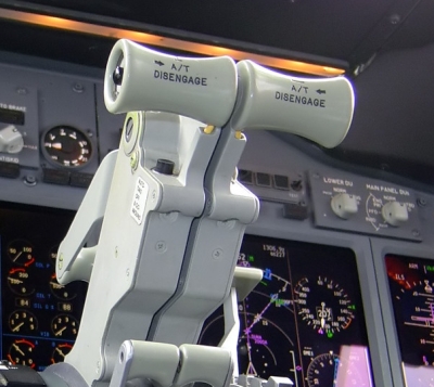

An other question...
This is about A/T engage and disengage.
On each throttle handle there is a A/T engage and a A/T disengage...
So my interrogation is... If I engage the A/T on one handle only, will it engage A/T on both handles or only on the handle I engaged?
Also, when on A/T, if I disconnect A/T only on one handle, will it disconnect one or both throttle handles????
I hope this is not a stupid question.
I imagine it will interract on both handles but I have no way to insure except to ask here...
Thank you,
Al

Intentional Left Bank
- Posts: 319
- Joined: Mon Feb 16, 2004 12:31 am
Re: Boeing 737NG simulator seeking pilot...
Either one of the A/T engage (or G/A) buttons engage BOTH thrust levers. Similarly, pressing one of the A/T disconnect buttons disengages BOTH. A good question and we're enjoying the photos.

Hi Intentional Left Bank,
How are you?
Thank you for your answer... This is what I expected to be but was not sure. Then I could reproduce the same...
BTW, I am still waiting for your visit...
Until now I received only one real 737 pilot... Very difficult for me to find because I leave in Quebec, witch is not the best place to find 737 pilots.... But still confident!
The photo above is from a real cockpit...

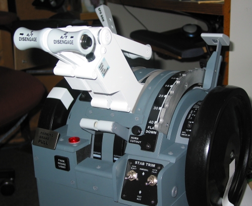

The next one is mine...
The reason there's 2 of each button is because of depending on which pilot if flying, the throttles are configured so that either pilot(left or right hand) will be able to disengage the autothrottles with their thumb, or engage with an index finger comfortably.

What a good reason...
Thank you for your explanation Four1oh

I just want to make sure you understand the button you are calling the A/T engage button. As I understand it, it doesn't engage the autothrottles, it engages the TO/GA mode. The autothrottles are engaged by flipping the A/T switch on the MCP panel. Hope that helps.
alphatango
- Posts: 117
- Joined: Mon Nov 17, 2008 7:47 am
- Location: Ville de Quebec
Jastapilot,
What a surprise! I thought both was the same action...!
Then I think I know what A/T is precisely... But could you explain in details what does TO/GA different from A/T?
Thank you for your help,
Alain

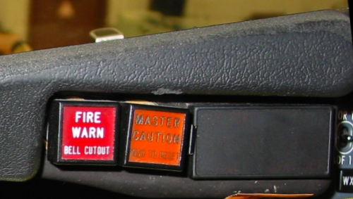

System annunciator panels
An other question to make the system working as closed as real one...
This is about "RECALL".
Let say that I have a Warning Caution light illuminated telling me that I have a FUEL problem. If I push on the Warning Caution button it will turn off the "FUEL" annuncement on the "System annunciator panels".
So, before fixing the problem if I push the "RECALL" button, will it illuminate ALL indications on the "System annunciator panels" while pushing on the "RECALL" button to finaly let only the "FUEL" light "ON" or will it illuminate ONLY the "FUEL" ligth while pushing on the RECALL button and once released?
This is not something very very important, but as we are making the programmation, why not do that as close as possible!
Thank you,
Al
Thank you,
Al
- System annunciator panels.jpg (113.62 KiB) Viewed 4859 times
Jastapilot
- Posts: 832
correct, but don't call it a 'warning caution', it's the 'master caution'.alphatango wrote:System annunciator panels
Every time you press the RECALL button, it's a light test. All lights on that and the other pilots 'Recall' panel will light up. Any existing fault will remain illuminated after you take your finger off the button. This is why we press RECALL as part of the landing checklist. That way you'll know right away if there's a fault you didn't know about, and you don't want to be landing if there's a fault you haven't dealt with.alphatango wrote:So, before fixing the problem if I push the "RECALL" button, will it illuminate ALL indications on the "System annunciator panels" while pushing on the "RECALL" button to finaly let only the "FUEL" light "ON" or will it illuminate ONLY the "FUEL" ligth while pushing on the RECALL button and once released?

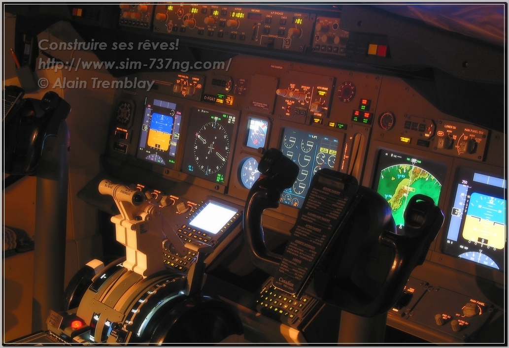

Hi everyone,
Thank you for that precision Dave!
I said I would keep you informed about the developments of my sim and on my site, so here it is...
Everything is in the home page. Like always, few text and many pictures ... a picture is worth 1000 words!
I had some problems during this update, then it is not complete ...
I have not been able to add more detailed pictures, just small ones, but it is a matter of time.
Also the link to the photos of the FMC does not work. It will be fixed soon.
But there are still a lot of news on my site which makes the visit worthwhile ... at least I hope!
So good visit!!
Incredible work! Amazing!
