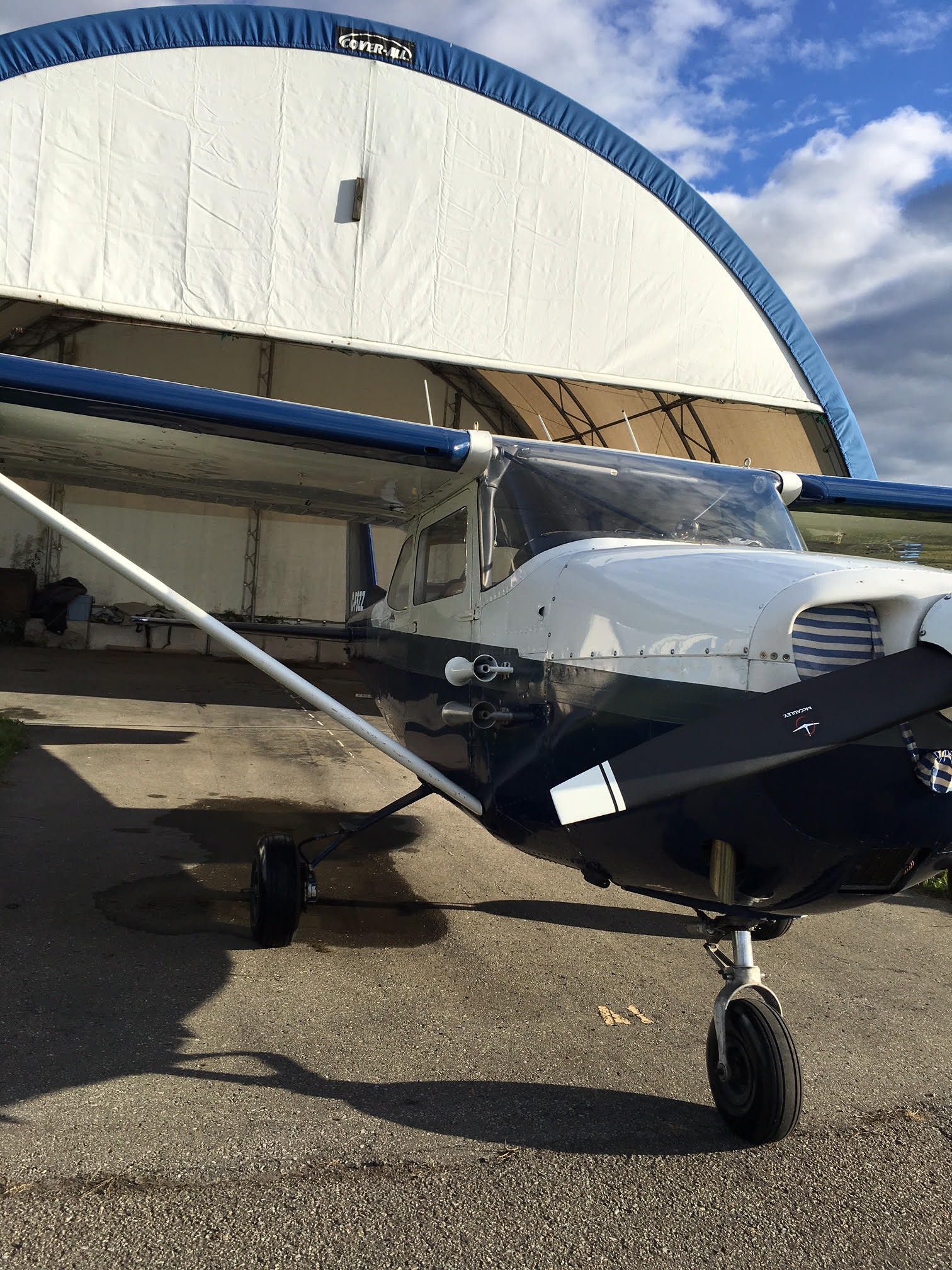

Here are some photos
- IMG_6539.JPG (469.63 KiB) Viewed 11095 times
- IMG_6536.JPG (431.85 KiB) Viewed 11095 times

What are those Venturi things on the right side?
Re: Cessna 172 1965-G o-300 on EDO2000 with Sportsman needs help considering WING-x
Used to power vacuum instruments, instead of using a vacuum pump. Nifty system, but only works with airspeed.

Wow. Nice plane. I have a 172 G with an 0300. I never thought it would have enough oomph to lift floats. Does yours have electric flaps?
Mine has a vacuum pump instead

Paint job? Yours looks pretty good. Besides, paint adds extra weight! I guess the vacuum horns threw me. Any older 172's I looked at had mechanical flaps with the air driven vacuum on them.
