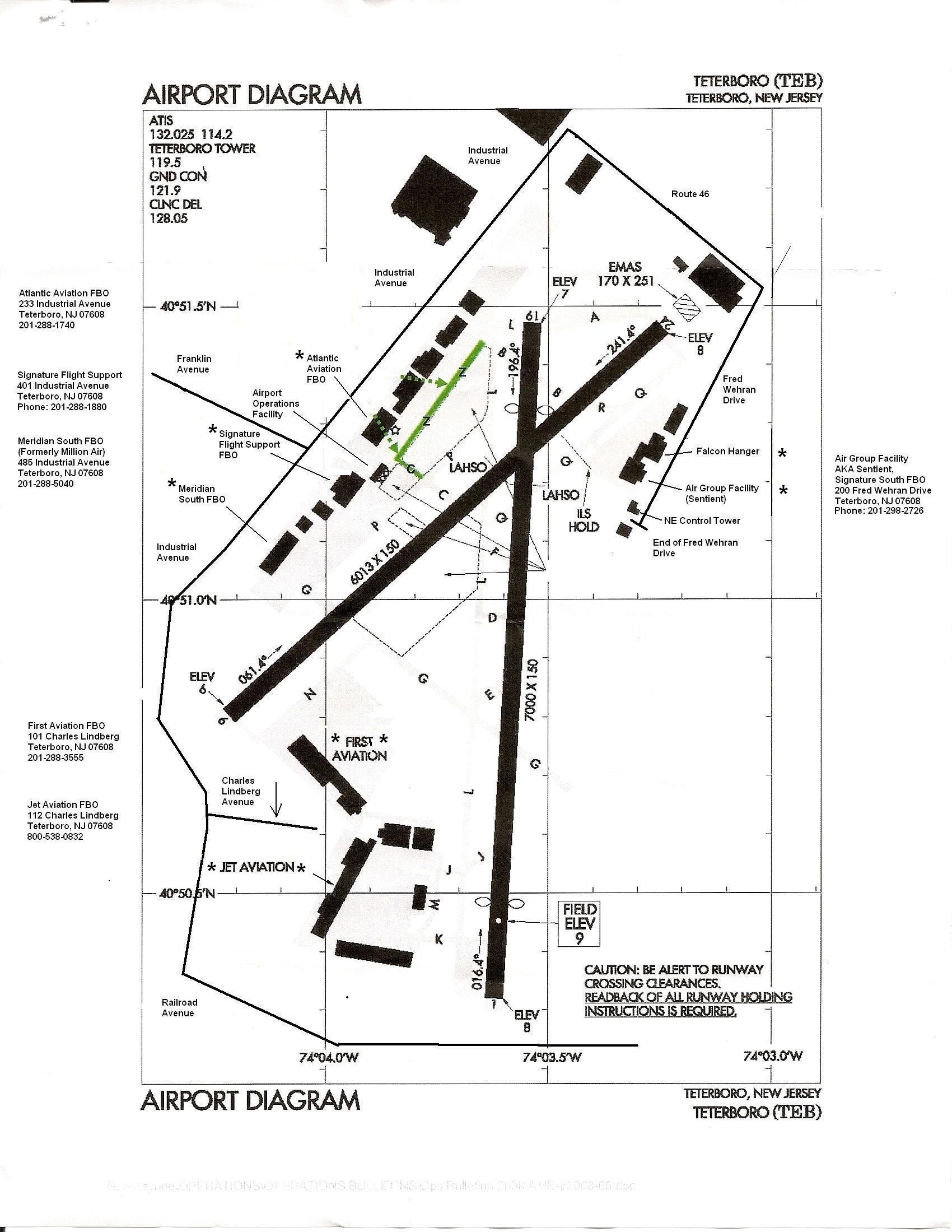

Split flap shouldn't be an issue as the 2 sides are linked. Lear 35s are very sensitive to being slow, final turn stalls are not unknown. Picture of aircraft shows it has Aronca TRs - can be "touchy" & only armed on before landing/final check depending on SOPs. See what the TSB finds.

TRs look stowed during the freeze frame video. I've done those circles into TEB many times before and its always a nervewracking experience. They like you to keep it within 2 miles and most of the times Ive been cleared the circle, its after being cleared the ILS for a crossing runway, so it almost always comes as a surprise.

I've got no IFR time but this part of the report was troubling. Are there rules out there for how close in you can be to circle for another runway?Radar track data indicated that the flight did not start its right circling turn until it was less than 1 mile from the approach end of runway 6. According to TEB ATC, aircraft typically start the right turn at the final approach fix for runway 6, which is located 3.8 nm from the approach end of runway 6.
- schnitzel2k3
- Posts: 1456
- Joined: Sun May 15, 2011 11:17 pm
Re: Lear 35 Crash at Teterboro
Well use your VFR knowledge.
What's going to happen if you turn too tight on a base to final, likely with lots of excess energy? Imagine doing that with an aircraft with little to no drag, potentially not configured for landing?
What are you going to have to do to land?
I think the LJs with their circling vref generally turn inside of 2.7 (might be 3.6) miles with the extended minima. So 1 mile is...well...
It aint going to going to be pretty, it aint going to be stable and you'll likely have the GPWS squawking at you the entire way down

There's no rule for how close you can be, but there is a maximum radius for the protected area:linecrew wrote: I've got no IFR time but this part of the report was troubling. Are there rules out there for how close in you can be to circle for another runway?
https://www.nbaa.org/ops/airspace/issue ... oaches.php
Were they to circle right almost a whole 360 deg( I guess more accurately, about 300 deg) to get lined up with rwy 1? or were they to sort of "turn right and shift over to approach for rwy 1?,ie make a right turn, then a left to line up quickly with rwy 1?"" what do we think?they the NTSB sort of hint that most planes "circle" at the marker, 4 nm back so that seems to hint that they just "slide right" and then turn left to go direct to rwy 1.
Of note also is that they had a clearance , but were kept low, charging around NYC at 4 then 3 thousand feet, at very close to 250 knots. That would not be much "fun" if you were the type to worry about traffic. I find NYC traffic plenty exciting while I am doing about 135 knots... with big windows, some would say I worry too much.

NY ATC expects you to keep up 250kts until they tell you differently, sometimes that's just as you're getting the localizer, then it's 190 to the final approach fix. Also, they likely would have been put down to 2000', sometime before that. I've never flown a Lear so don't know the difficulty in slowing them down. I do know that the ILS 06 circle to land 01, is a fairly common approach given and not overly difficult to fly....if properly prepared for. If you see the chart that I've attached though, starting your turn 1/4nm or, whatever it actually was, from the threshold of 06 puts you in an extremely difficult position to do a proper circle to 01, starting the circle at Torby is tight enough.anofly wrote:Were they to circle right almost a whole 360 deg( I guess more accurately, about 300 deg) to get lined up with rwy 1? or were they to sort of "turn right and shift over to approach for rwy 1?,ie make a right turn, then a left to line up quickly with rwy 1?"" what do we think?they the NTSB sort of hint that most planes "circle" at the marker, 4 nm back so that seems to hint that they just "slide right" and then turn left to go direct to rwy 1.
