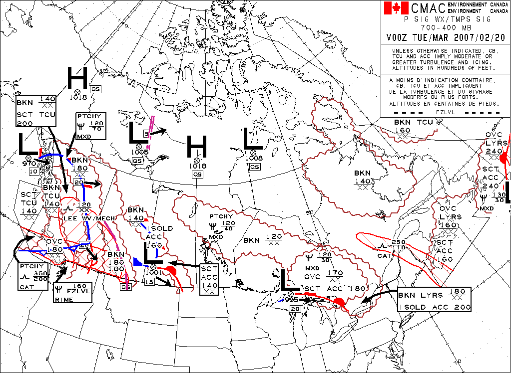

Can anyone tell me what the 2 solid magenta lines beside the L (1005) mean please?
Re: SARON / SAMRA Feedback
Posted: Wed May 16, 2018 6:16 am
by Loner
Upper Trough
