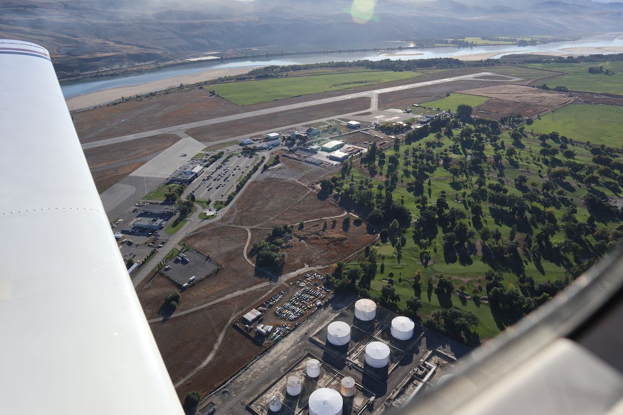

Here at Kamloops we routinely land long on 09 - coordinated with FSS, of course - since the taxiway to the Flying Club ramp means you'll be rolling to the end of an 8000 foot runway. Stabilized approach (always!), pick and hit your touchdown point, all the usual stuff. Pilot decision making and all that...
...laura
...laura
- IMG_1497.jpeg (165.6 KiB) Viewed 6575 times
