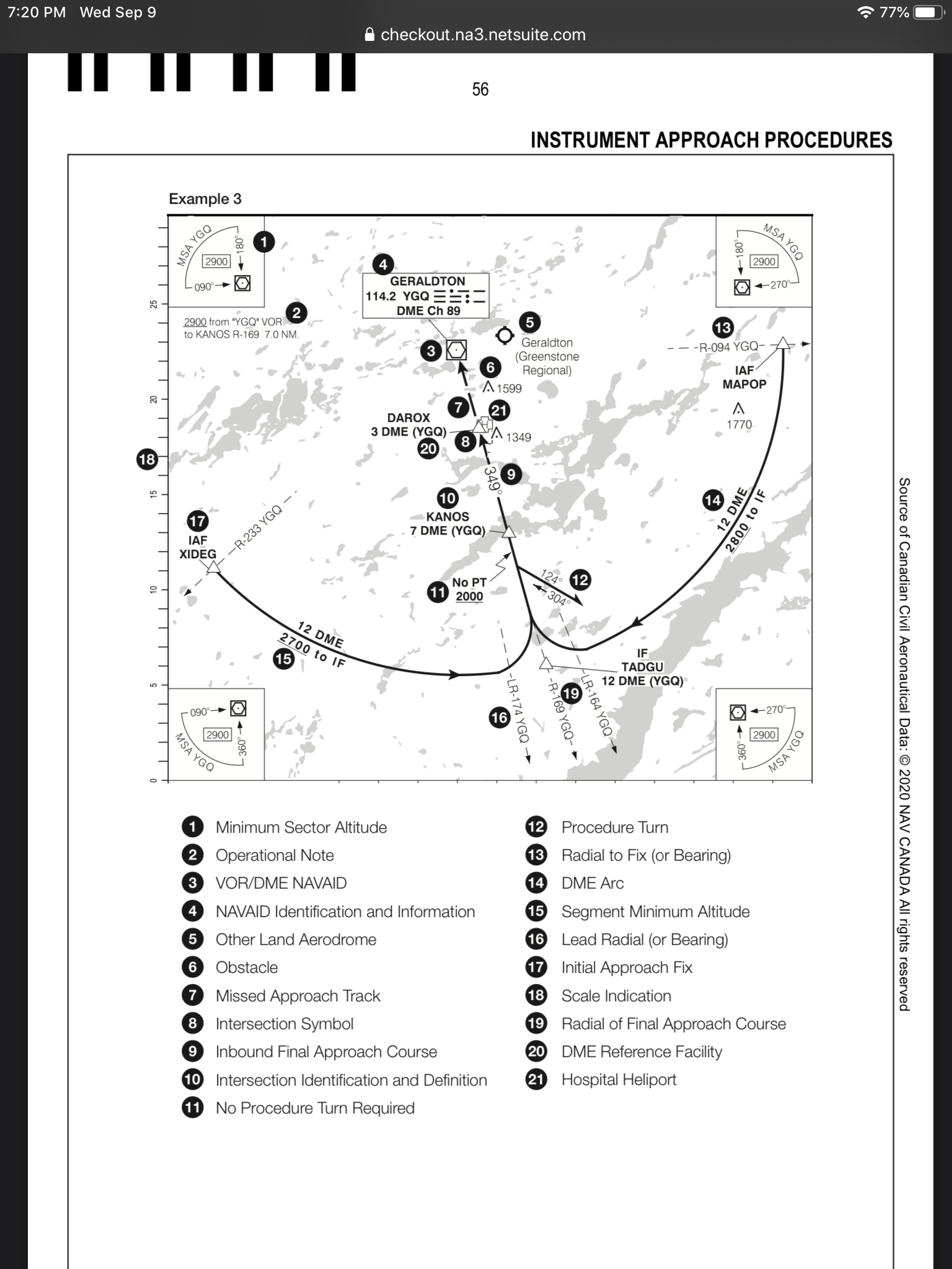

Simply means no procedure turn is required even though one is depicted and if you are going to do one (not sure why you would because the approach requires ATC radar or GNSS) it must be completed within 6 miles of the FAF DAXUN.
From CAP GEN see number 11 -

... or this see number 9 -

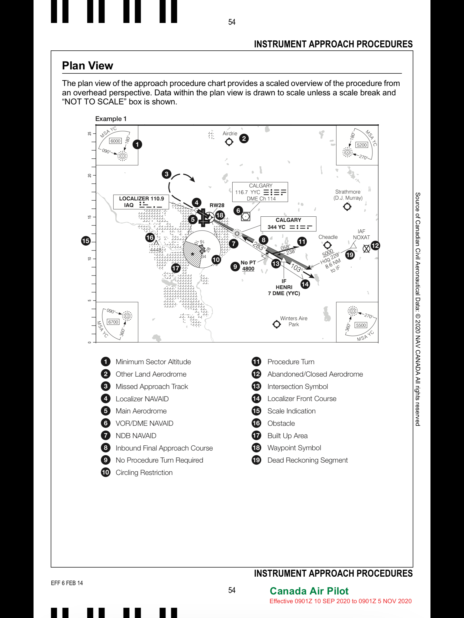

.. from TC AIM RAC 9-16 -
“The abbreviation “NO PT” is used to denote that no procedure
turn is necessary from the point indicated and will normally be
shown adjacent to the IF. However, if the minimum altitude IF
to the final approach fix (FAF) is not readily apparent, the “NO
PT” abbreviation may be shown at some point between the fix
and FAF, along with an altitude applicable for this segment.”
