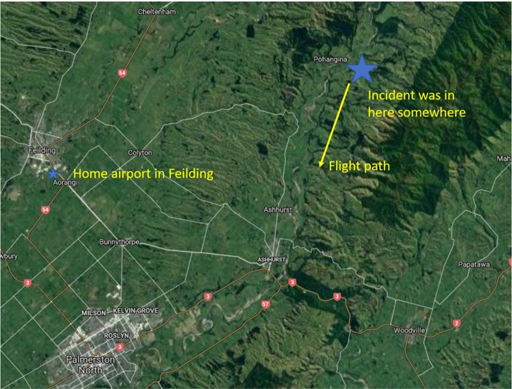

DirtyDashDriver
Posts: 50
Joined: Sun May 12, 2019 12:00 pm
Re: Glider Loss of Control and Near CFIT
Post by DirtyDashDriver »
I wonder what the cloud clearance requirements are in NZ, and when they were violated.
Same as Canada, and yes. 5km visibility, 2km from a cloud, and 1,000' vertically. If below 3,000' ASML, 5km visibility and clear of cloud.
They were Class G where they were, but the eastern CTA for Palmerston North begins at 4,500' from pretty much where the video would begin based on when the one pilot says he can see Pohangina.
I don't understand the choice to turn left around the last cloud.
I do and don't. I do because the Ruahine Range turns slightly east between Pohangina and Ashurst a couple of km south. To keep over the terrain, they would have had to turn left. I don't because weather knowledge is pounded into pilots during license exams in NZ. Or it was when I did it. The weather in that area is the same as BC - that cloud just stacks up against the ranges and with a westerly wind doesn't go anywhere for days.
Incident Location.jpg (129.86 KiB) Viewed 2337 times
Posts: 7975
The diagram above makes it look like the airfield was to the right....where the better weather was located. Are you sure it is correct?
