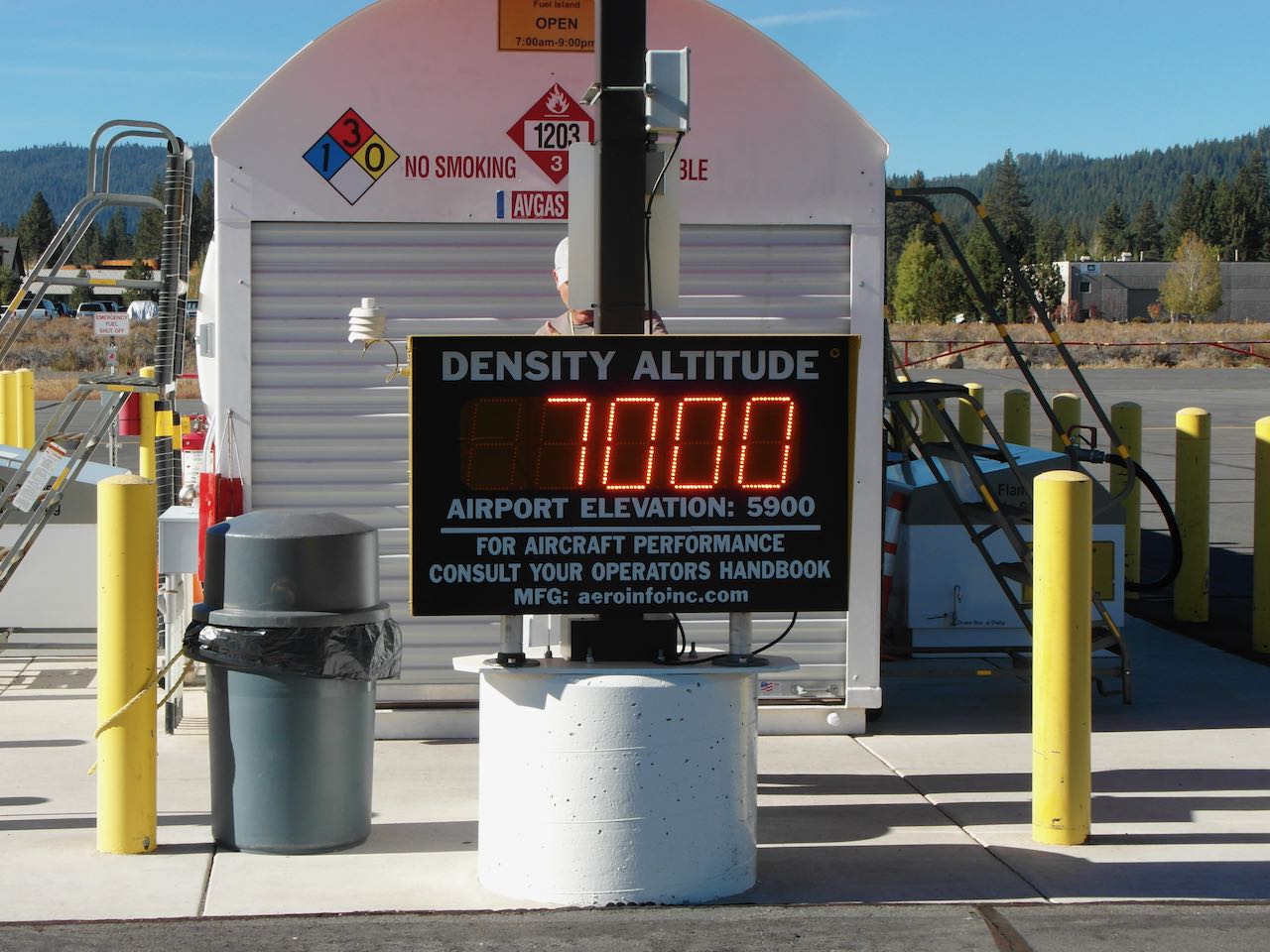

That was part of my motivation for doing The Finer Points mountain flying course a couple of years ago. Our base was KTRK, field elevation 5900 feet. Much higher density altitude in the afternoon. Flying passes at 11000 feet passing around the oximeter. Great!
...laura
