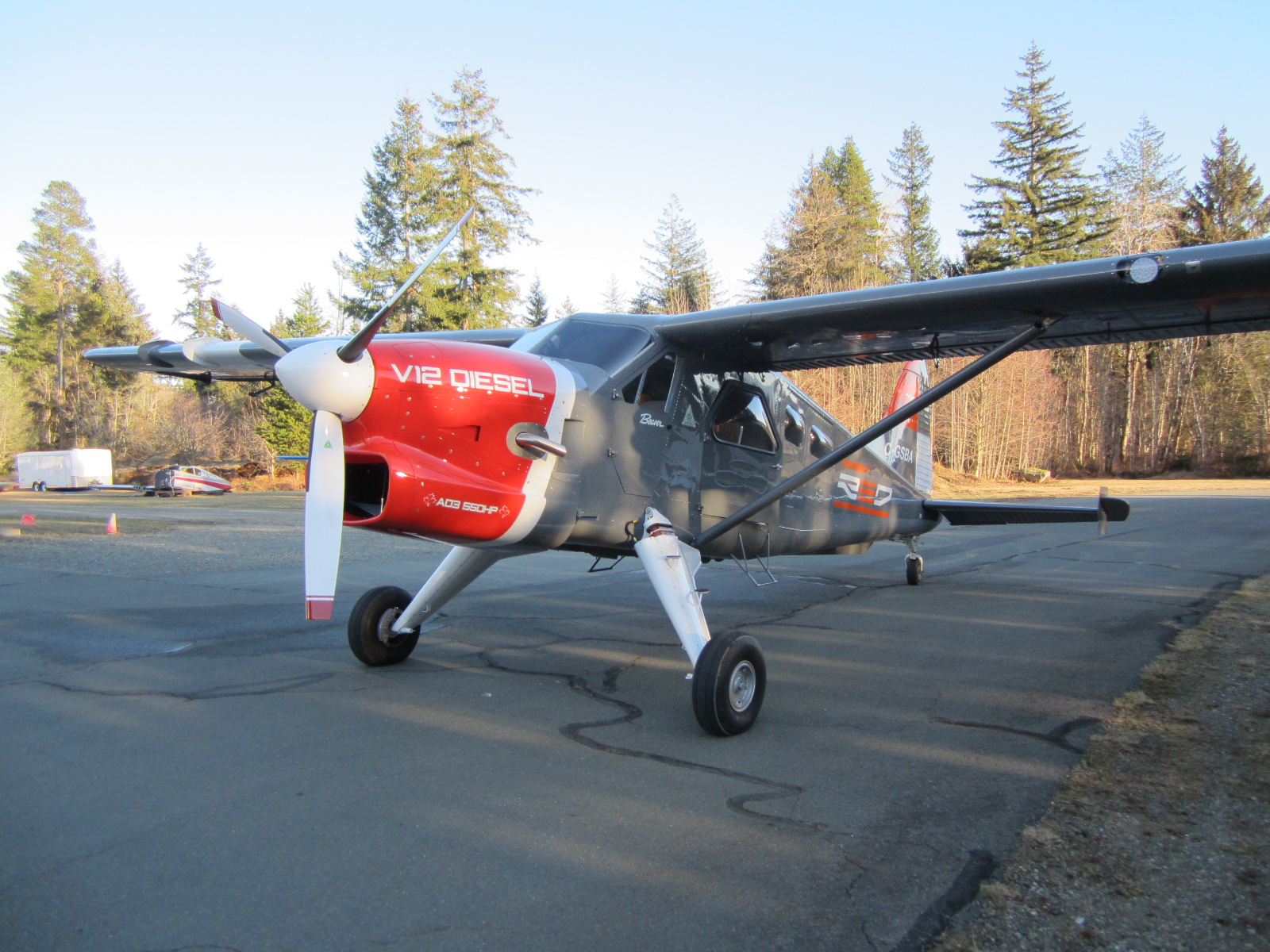

The Sealand RED V12 Diesel Beaver flies!
PilotDAR
Posts: 4113
Post by PilotDAR »
Yesterday, with Sealand's pilot, we flew the first two flights with the RED V12 powered diesel Beaver. A new era begins!

Nifty.
I gotta ask though, why not just go with the PT-6/DHC-2T conversion versus reinventing the wheel with a diesel?

Posts: 7132
Re: The Sealand RED V12 Diesel Beaver flies!
Cool! Do the diesel engines require special props as well?
rigpiggy
Posts: 2969
Post by rigpiggy »
Just an M T prop(not a fan, but wh at do ya do). Beside the fuel burn, you also have to think cycles as well as time in turboprops. This is a 550hp donkey that would have a cruise fuel burn of about 12 gph of cheaper fuel( between .50-1.00). so based on say 500 hrs a year 4 gph diff at cruise would be almost 100/hr. Plus I'm betting the aerodynamics will be better so maybe an extra 15-20 mph or 8-15% faster. Figure close to 30% reduction in DOCs. If I win the lotto........this would also be an awesome retrofit on c421s

Posts: 7132
The red makes the engine look massive! Very cool! Hope we see more diesel engines soon!

PilotDAR
Posts: 4113
Post by PilotDAR »
According to Flightaware these were only 2 minute flights.
The Flightaware information is not accurate. The first was a circuit, just as a first flight, the second was a few thousand feet up over the airport, while we gathered some engine operating information for about 15 minutes. I won't present any detailed information, as it is not mine to offer, but I can say that the airplane performance was very pleasing. The JET A fuel consumption was similar to a thirsty IO-550.
Yes, Sealand at Campbell River (CYBL). They have made a magnificent installation.

PilotDAR
Posts: 4113
Post by PilotDAR »
I flew the Sealand/RED diesel Beaver for 1.3 hours this afternoon, what a performer! Cruise at 4500 feet altitude, 6C OAT, 80% power; 158 MIAS, with a jet fuel burn of 93 L/Hr. Climb rate through 8500 feet (today's ceiling) was still 1600 FPM at max continuous power. More flight testing tomorrow. We've got more work and testing to do, and a way to go for STC approval, but it's a spectacular beginning!

PilotDAR
Posts: 4113
Post by PilotDAR »
I climb tested the Sealanad/RED diesel Beaver today with Bill as my observer. We took off at 6000 pounds gross weight, passed 10,000 feet in less than 10 minutes, and were still climbing at 600 FPM as I reached 16,000. External factors today prevented going higher, but the plane certainly would have! Temps and pressures all perfectly fine. After an hour and a bit, including a 110% Vne test to 202 MPH, some stalls, and an air to air photo shoot. I landed back at Campbell River airport - at 5850 pounds, as I had not burned much fuel, pretty heavy for a wheel Beaver landing! A great flight!
