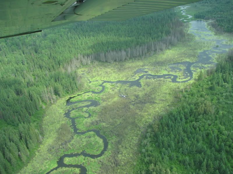

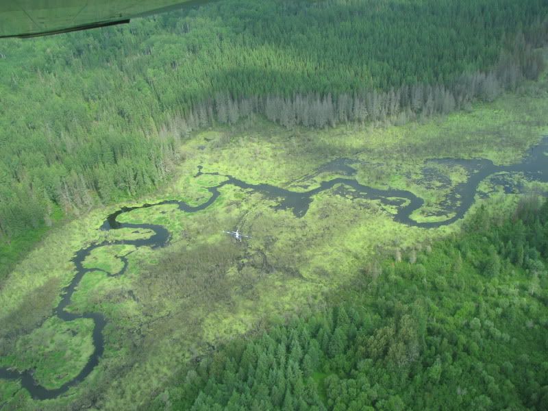

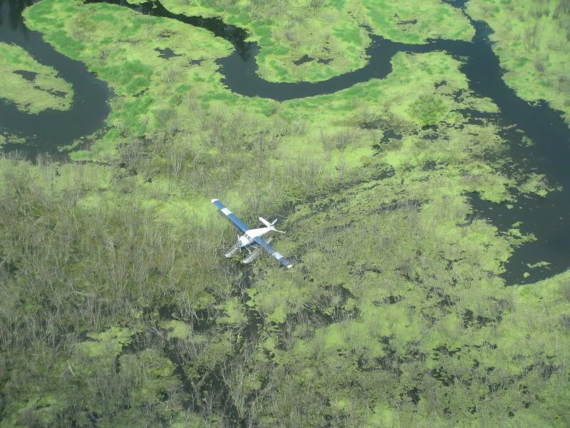

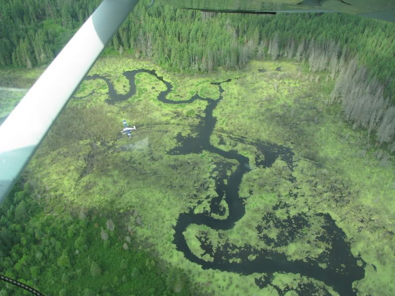

Thanks for the pics Blakey. I was wondering what it looked like. Great job by the pilot, thankfully no one on board was hurt.

Good to hear everyone ok, but the plane looks a little twisted!

The amphibious float-equipped Konopelky Air Service de Havilland DHC-2 Mk. 1 Beaver aircraft (C-GPUQ) was departing on a VFR flight from Cochrane (Lillabelle Lake) water aerodrome (CNN5) to [destination not reported]. NAV CANADA staff at Toronto ACC were advised by J.R.C.C. Trenton staff at 1200Z that the aircraft had crashed in a swamp area just after take-off (due to an engine failure), approximately one (1)NM north of Lillabelle Lake (46º71'56"N 081º13'08"W). J.R.C.C. Trenton staff advised that there were no injuries to the five (5) people on board and that they had all exited the aircraft and were walking to the nearest road to be picked up by the Ontario Provincial Police (O.P.P.).

The Konopelky Air Service DHC-2 aircraft (C-GPUQ) was departing from Lake Lillabelle for Stringer Lake. Approximately 3NM north of the departure point, the engine (Pratt & Whitney R-985) started to make unusual clacking sounds which were quickly followed by a complete failure. The pilot completed a forced landing in the most suitable spot which was a swampy area near a small stream. On touchdown, the aircraft's floats stuck several obstacles which were on or just beneath the surface, causing extensive damages to the floats and float struts. The aircraft came to a rest with one wing and part of the empennage in the water. The pilot and all occupants were uninjured.

Thank you for the details! Good job on the part of the pilot - everybody walked away... that's awesome. I wondered why the tracks curved into the scrub at the end of the run, but from the report I gather he/she didn't have any choice in the matter. I hope somebody gave that pilot a big hug and bought them a beer.

Nice to hear the positive comments on this. I was the pilot. First season on the machine. Love the plane even more than I did before, for obvious reasons. The account in the other post is relatively true. I'll pass on what I learned. At 300 AGL you have no time. I guess 15 or 20 seconds. That amount of time with all the destactions is a blink. Airspeed and point it down. You won't time have for all the stuff you were taught, but keep flying it and sort out the rest later. Don't worry about crapping your pants, that comes naturally.
Take care. Thank God and Dehaviland.
