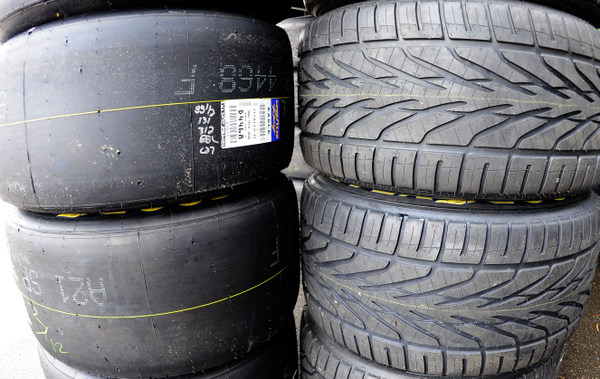

Re: When to change a tire
I've contacted my favourite NASCAR team and passed on what I've learned here. They are absolutely thrilled to know that they can quit wasting money and precious pit time on changing to rain tires on wet days. Now they know all they really need to do is inflate their regular slicks to 472 PSI and they’ll be just fine on a wet track at 200mph+.
It's too bad, really; internet forums can be great learning tools for all. Unfortunately there tends to be a core group that lurks on every forum that just can't help turning a friendly discussion into a mudslinging put down fest, or an argument for argument's sake, even when they know information and ideas they are putting forward is twisted or inaccurate.
- Tires.jpg (94.01 KiB) Viewed 4369 times
