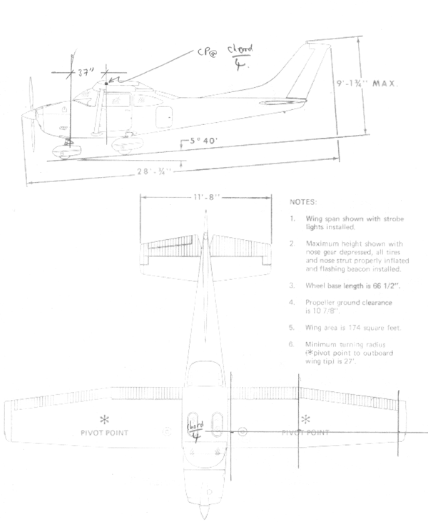

Here's the engineering drawing of the C182, from the POH, with the quarter chord drawn in. It's at station 37" from the firewall: The CG limits for the aircraft are 33" aft of the firewall to 48.5" aft of the firewall.
Any time the CG goes rearwards of about 37" (which is most of the CG range) the tail is lifting.

Interesting..... maybe I need to start teaching C of G a little differently.

(2) For stick controls, W/140 (where W is the maximum weight) or 15 pounds, whichever is greater, except that it need not be greater than 35 pounds.
[(b) The requirement of paragraph (a) of this section must be met at 75 percent of maximum continuous power for reciprocating engines, or the maximum continuous power for turbine engines, and with the wing flaps and landing gear retracted--
(1) In a turn, with the trim setting used for wings level flight at VO; and]
(2) In a turn with the trim setting used for the maximum wings level flight speed, except that the speed may not exceed VNE or VMO/MMO, whichever is appropriate.
[(c) There must be no excessive decrease in the gradient of the curve of stick force versus maneuvering load factor with increasing load factor. ]
That means that there must be positive elevator (downforce) control force required to pull G. As per (c), it must not be permissible that the elevator control force decrease as you increase G. This requirement protects the plane from being overstressed by a careless pilot, because the pilot will have to put the muscle into pulling the G, so it won't happen unknowingly.
If ever, the tail were lifting, this could not be achieved - the elevator control forces would be all wrong, and would not increase as G increased. Look at my control force graph again, this unacceptable characteristic is plotted there.
- Colonel Sanders

@PilotDAR:
I see 2 elements in your post I'd like to address.
If 'yes', draw the forces on a line. You'll get
(nose airplane) -- Lift (UP) -- CoG (DOWN) -- Tailplane (X)
Now, the airplane rotates around the CoG. If the Lift goes up, the X needs to go upward as well. If not, you'll create a moment which will make the airplane rotate like a windmill. It's like 2 children sitting on a swing: for the swing to be in balance they both need to sit down or stand up.
Regarding the stall: I do not know enough about it to discuss it in depth. However, the tailplane stalls later than the wings, which allows you to keep the aircraft stalled or recover from it (but that's more Colonel Sanders' expertise
Regarding the elevator control forces:
as far as I know there is no way you can deduct which way the tailplane is lifting (up or down) by the stick forces. The stick forces are an indication of how far you are "away" from the equilibrium point. This equilibrium point is roughly set by horizontal stabilizer and finetuned by your elevator trim. This is the equilibrium. Let's say the tailplane generates a force X on the airplane in equilibrium. You won't feel anything in your yoke. It doesn't matter if this force is positive or negative. What you will feel is an increase in lift (which is the same as a decrease in downforce) when you push the yoke or a descrease in lift (increase in downforce) when you pull the yoke and move away from the equilibrium.
Do you agree that it is possible that the center of gravity moves behind the center of lift ? If no, please explain. Because from the schematic in one of the posts above, it is possible that the CoG moves behind the CoL.I disagree. The downforce on the tail is what creates a stable plane. If there is an upforce, no force, or a transition between down and up force, the aircraft will be unstable.
Re: Single engine Cessna tailplane lift
The nose down moment created by the wing (the forces within the wing itself), conteracts and overcomes the "nose up moment" created by a CoG behind CL. Thus requirering a tail down force even with the CoG at the aft limit.

If the C of G is behind the C of L of the main wings then theoretically you have (up) lift from the tail.
If based on that assumption the wings stall first, then the tail would still be providing lift as long as the critical angle for the tail hasn't been reached. If that's the case the loss of lift from the wings plus the continued lift behind the C of G would still lead to the aircraft pitching down in a stall. In theory anyway. It does depend on what the critical angle for the tail is in relation to the main wings.
And don't worry PilotDAR, I'm not going to change the way I teach on a whim. If however, this is anything like the way Bernoulli and equal travel used to be taught for theory of flight, I need to consider the possibility of change.

I'm on the edge of my academic qualification in discussing C of L and C of P topics, but, I will assert that the C of G of the aircraft will not ever be aft of the center of total lift provided by the wing, including any pitching moment for the wing in that configuration. The drawn schematic does not include the pitching moment of the wing.
The higher the G loading acting on the plane, the more load acts downward through the C of G. Therefore, to remain in equilibrium, the higher the lift must be from the wing, through its center of lift. Therefore the greater the downforce must be from the tail to balance the increased lift produced by the wing, from the combination of increased AoA and/or speed. This is how Va is determined, the speed at which the aircraft stalls before it is overstressed. The tail stalls, and releases the download, which reduces that angle of attack of the wing, thus preventing overstressing. Faster than Va, the tail is capable of exerting so much down force that, the wing can be overstressed.
The wing may stall before the tail, but not necessarily. When you are in unaccelerated slow flight, and you pull back too much, the nose drops. That could be because the wing has stalled and the front of the plane goes down, or it could be because the tail stalled, and the back of the plane went up. It's kinda hard to tell sometimes. However, when you consider aircraft like the Cessna 177 Cardinal, which have a stabiliator, it is definitely possible to stall that, and drop the nose before the wing stalls at all - at any C of G position. This is the reason why when you look at one, it has an inverted slot in a part of the leading edge. The early ones did not, and were found to be wanting in low speed handling, resulting in some banged nosewheels. The tail had a downforce all the time, though sometimes not enough relative to the whole plane's forces.
It's not the force on the elevator control, but the change in force per change in G (with no change in trim) which matters. In the graph I presented, the equilibrium point is 70 knots, where I have trimmed out the pitch force to zero, from there, I did not retrim, but measured the force on the stick as I slowed, and changed power. When you see my results showing a push force as the plane slowed, and worse a pitch force which did not change as the speed further reduced, you are seeing a plane which is very unstable, and difficult to fly. I cannot tell you if the tail was actually lifting at that point, or just providing a very small down force relative to all other forces, but it was not approvable. If it actually was lifting, it would just be the same or worse than what I measured, and certainly not approvable.
Remind yourself that pilots who have only ever flown type certified GA planes have a sense of "normal" which has been very carefully designed in to conform to the certification requirements. There is a whole other realm of aircraft that do not fly as well, and may have very different characteristics. Military and amateur builts being the most common examples. Sometimes the instability is purposefully designed in (aerobatic types), sometimes it's just a poor design (what I have graphed).
