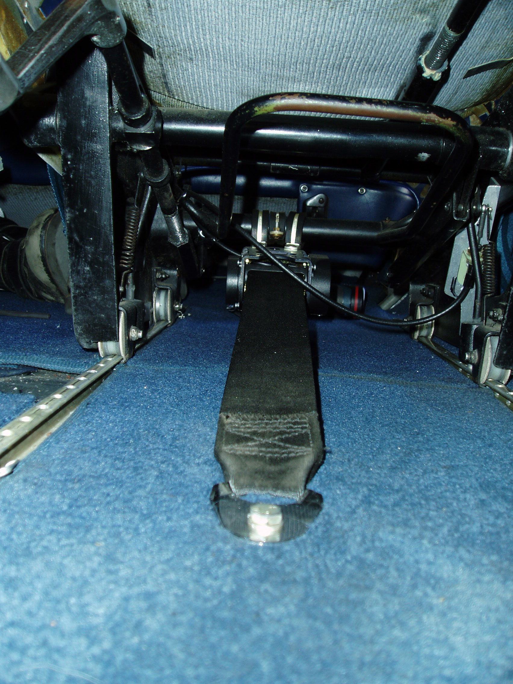

A simple safety strap may be required to ensure no travel past the 'farthest back' position ... located out of the way under the seat. Like a seat-belt for the seat itself (like the strap on a car seat) but placed out of sight .. just for 'in the event of'
The earlier old style seat rails were probably designed (longeivity-wise anyways) more for 20th-century style pax weights. We've seen the photo lately, an example of the butt-size that is getting into these lightweight seats more often, so maybe that's the whole new problem. You hear of seats actually breaking on some larger aircraft ... so maybe the overall problem is more widespread first imagined.
GyvAir
Posts: 1810
Re: Cessna 185 down in Mont-Laurier
Post by GyvAir »
Pun intended?:
pdw wrote:widespread
pdw wrote:Like a seat-belt for the seat itself
That in fact is exactly what the above posters have been referring to with the secondary seat stop bulletin. For those unfamiliar:
