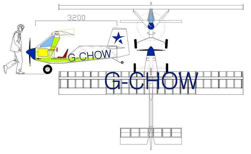

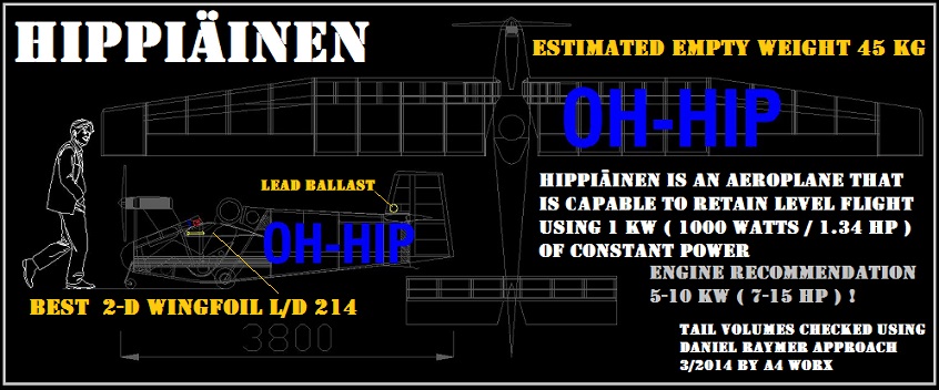

I have been working on this since 2007.
Idea is to move at 1-1.5 kW constant power....thus able to go on solar power with a plane that costs just 6000 usd.
Anyone interested ?

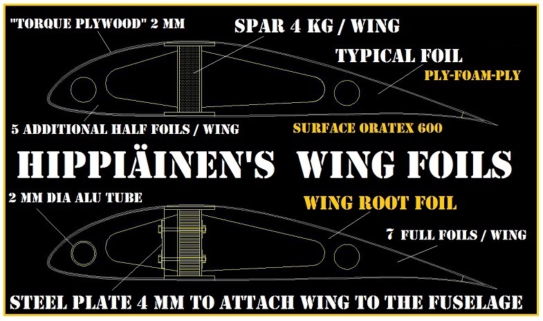

Interesting concept. Just a few questions:
1) What country are you located in? Your name and the aircraft registration indicate Finland.
2) What is the 2" aluminum tube in the front ribs for?
3) Is it possible to streamline the motor so that is is not sticking up on struts?
4) Adding lead indicates it is a bandaid to fix W&B issues. Usually results in less efficiency.
5) Will the motor/battery/controller system have enought power to take off under it's own power?
6) Having 5 ribs in the leading edge and 7 ribs behind the spar may require the spar to be heavier to resist bending moments due to the odd spacing.
Keep us posted on the development.

Good Morning !
1. I am located here in Finland..in the town of Oulu ( Uleåborg på svenska ).
2. The 2 mm thick 50 mm dia alu tube is to connect the leading edge ( FRONT ) of the wing into class fibre holster on the fuselage.
3. I also drew the engine in in another drawing. This gives change to survive if the batteries melt/explode.
4. Yes the ballast is shematic..you need to have CG front in an all moving rudder.
5. That is the idea to get it to 3 km to get the sun...or ½ hr flying time. This might do ok in a good thermal too.
6. I think you have the wrong pic now due to wrong picture. I post new ones. This wing on Hippi/Hipster imitates a bird wing in many ways.

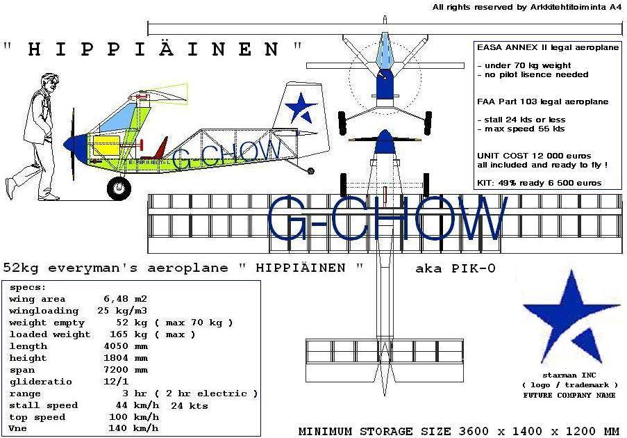

If and when we get this going would you be interested of a precut kit with an engine accus regulator prop and few molded pieces along all the foam + wood pieces ?
This plane is aimed to be fully FAR Part 103 legal. Also needs no lisence here in Finland to fly.
This is intentionally a bit RETRO looking but I guarantee it is very high tech gadget !

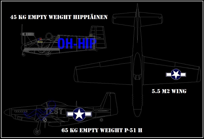

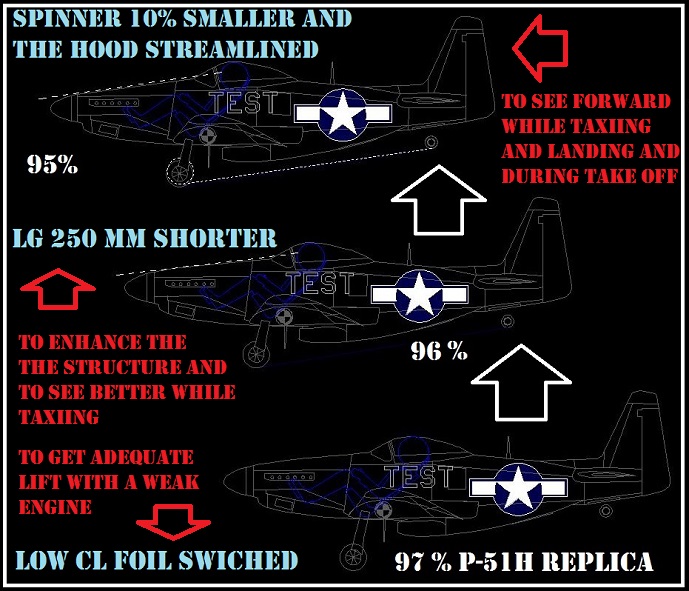

I am not getting much positive response to the electric/solar craft ( maybe time isn't ready for them yet ? ).
How about a ½ scale P-51 H to be used with paraglider engine and two blade prop ?
P-51 H is my all time favourite and the ultimate MUSTANG.
Wing loading is 20 kg/m2 and you could carry golf clubs in the belly scoop..which is then converted into a belly cargo room.
I estimate with fixed LG about 6-7000 usd for the craft if self made and 10 000 - 15 000 as a kit.
Anyone interested ? :rolleyes:

Loading with 110 kg pilot around 31 kg/m2..and then stall at 30 kts.

Does anyone know where to get film thin 20% efficient solar panel..at moderate price...or at any price ?
P-51 H would be awesome, but the old design has some appeal still ( compact and light ).
Which one would you prefer...open cockpit 70 km/h max electric or 100 km/h 2-stroke with recuction gear and closed cockpit ?

I was able to calculate 83 kts at 4 km altitude and loaded perhaps 64 kts at sea level.
I think my lite yet durable "climbs like bat outa hell" wing will be a winner in electric business.
I don't think the short fuse in Hippi is a problem since it has only top speed of 45 kts.
