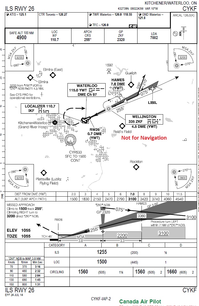

Question. You hold at YKF NDB at 5000'. On the outbound after entry you get cleared for the ILS 26. Do you have to go back to the beacon for one more loop before commencing the descent for the approach or can you descend to 3200' on the outbound right there then join the inbound on the localizer in one shot? Can you shuttle down slowly doing as many laps as needed to get down to the PT Altitude and then commence the approach when ready even if it means 2 additional hold laps? Just wondering what options are available to the pilot and what ATC really expects you to do.
Thanks! I hope I made the question somewhat clear

Sounds good, thanks guys. One more thing. What is the purpose of HAMES Intersection. It also shows 3360.

I can only find older (2012 charts) but it can be used as an IAF. It also lines up with a glide slope intercept altitude or 3 degree slope for NPA.

Cavespring, the purpose of the HAMES fix is to provide adequate airspace for the Guelph Airpark circuit which is located below the procedure turn.
YKF ILS.jpg (226.05 KiB) Viewed 2830 times
The 3360 note at HAMES means that on the glideslope, you will cross HAMES at 3360'.
Once you are cleared for the approach, you may start your descent, regardless of where you are in the procedure. Just know what the minimum altitude you can descend to is at that time. In many cases, if you are not holding on the protected side, you still have an MSA that applies to the area that you are in, and in this case is within a couple of hundred feet of the PT altitude. Also, as you know that the HAMES crossing altitude is 3360, you don't need to be level at 3100 when you turn final. In fact, once you turn final, you can descend as low as 3100, (2200 once inside HAMES), but you may not want to rush down to these altitudes if you have captured the glideslope; just follow it!
