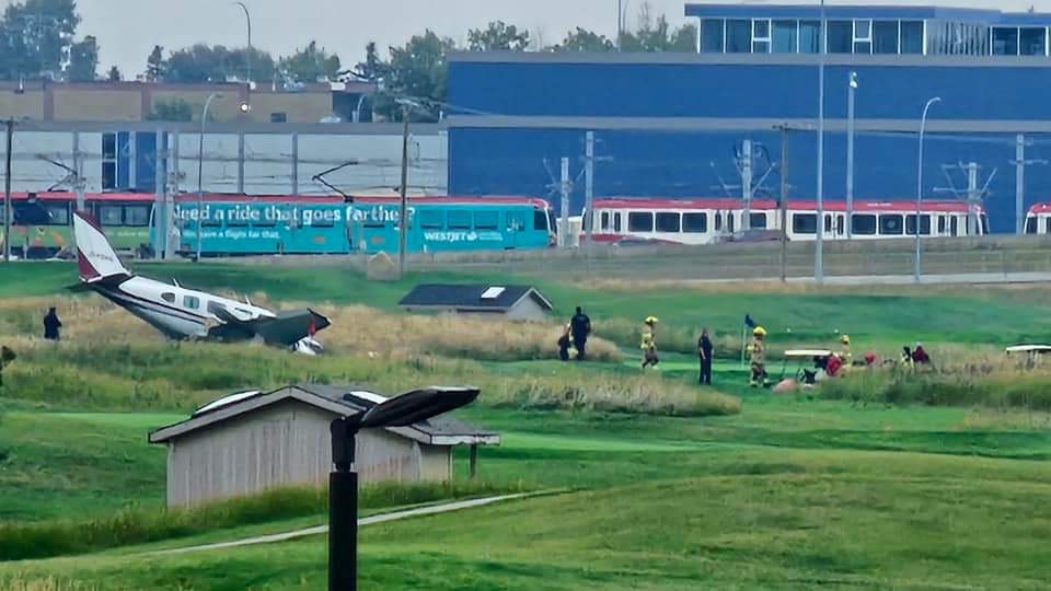

Anyone notice the WestJet ad on the C train in the background? Really didn’t have to go much farther but it is good to know WestJet had his back.
Engines don’t look like they were running on landing. Hope this isn’t another pilot running the aux tanks dry. We already had that idiot who landed a Navajo on a busy street.

trey kule wrote: Fri Aug 16, 2024 5:23 pm Anyone notice the WestJet ad on the C train in the background? Really didn’t have to go much farther but it is good to know WestJet had his back.
I’m no expert but that right one looks like it was running, left not so much.

Right hand prop looks feathered.

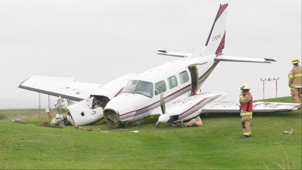

Doesn’t mean anything. The blades want to go to feather with no oil pressure and the latches can break or not latch if they aren’t on the low pitch stop.

Both look like windmilling at impact.

C-FZHG, a privately registered Piper PA-31 Navajo operated by Airborne Energy Solutions Inc.
was conducting a round robin instrument flight rules flight from Calgary International Airport
(CYYC), AB, to Hinton/Entrance Aerodrome (CEE4), AB, and back to CYYC with only the pilot on
board. The plan was to conduct the flight without refueling in CEE4. Prior to departure from CEE4,
the pilot determined there was sufficient fuel for the return flight to CYYC. While in cruise, with the
left engine being supplied by the left outboard tank, the pilot observed the left engine fuel pressure
start to fluctuate, and the engine operation became erratic. The pilot then selected the left engine
to run on the left inboard fuel tank. Concerned about the fuel quantity in the left-wing fuel tanks, the
pilot elected to cross feed the left engine from the right-side fuel system. During the final approach
into CYYC the right engine stopped running. The pilot secured the right engine, feathered the
propeller, declared a Mayday with ATS and elected to continue the approach. Two to three minutes
later, the left engine stopped operating, and the pilot proceeded to perform a forced approach onto
a golf course located directly south of the approach end for Runway 35R. The aircraft came to a
rest approximately 1/2 nm south of the threshold for Runway 35R. The pilot received minor injuries;
however, the aircraft was substantially damaged. There was no post-accident fire. CYYC aircraft
rescue and firefighting, the CYYC airport authority and the Calgary Police Services attended the
scene.
On site post-accident examination of the aircraft found the left-hand fuel selector in the outboard
position, the right-hand fuel selector in the off position and the cross-feed valve in the off (normal)
position. The aircraft was subsequently removed from the golf course and transported to a secure
location for further investigation. The investigation found that there was no fuel remaining in the left
inboard, left outboard and left nacelle fuel tanks. The right nacelle tank was empty, however
approximately 24 USG were recovered from the right inboard, and approximately 29 USG were
recovered from the right outboard fuel tanks.
