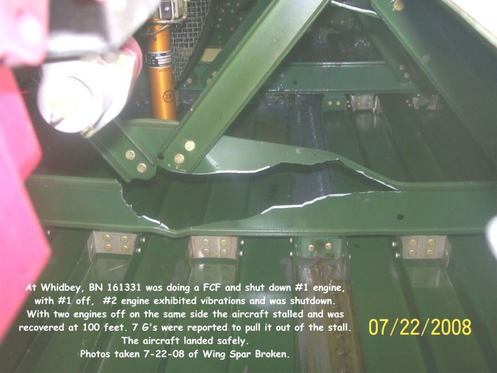

Note not only the separated wing panel, but the noted recovery altitude of such a large aircraft......

"...This is what I heared so far (info from several sources put together by me): At NAS Whidbey Island, Washington, P-3C 161331 was doing a Functional Check Flight. They shut down #1 engine. With #1 off, #2 engine exhibited vibrations and was shutdown. With two engines off on the same side the aircraft stalled. 7 G's were reported to pull it out of the stall. 45 consecutive rivets were pulled out on the stbd wing during the 7 G pull out (rolling pull), after peaking at negative 2.4g's as well. They did five spin rotations from 5500 ft- - they bottomed out "between 50 and 200 ft"!! They could see the inside of the fuel tanks when they landed. They were at 160 KIAS, appr flaps during a prop fails to feather drill on #1 when #2 started surging. They bagged #2, but while doing so got to 122 KIAS. When they added power, they were way below VMC air, and departed. SDRS recorded the flaps being raised and the landing gear being cycled down and then back up. Aircraft released all the fuel in tank #3 when it appears that the seam between planks 3 and 4 split. Tank #4 also lost its fuel load when plank #1 separated from rest of the aircraft wing. Regards, P-3 Orion Research Group - The Netherlands..

It's interesting to see the damage to the wing in light of the fact that some early L-188 Electra's shed complete wings in flight. The reason's behind it were completely unrelated, but it's an interesting annecdote.

When this thread first started I was going to point out that it's impossible to pull 7 g's unless you're going really really fast. But then I realized it said "rolling g". A while back someone with a really good understanding of aerodynamics gave a good explanation of rolling g, and I certainly think it's possible even from a stalled condition. A 3-4 g pullout from a dive after recovering from the stall, plus an aggressive roll to wings level flight could certainly pop some rivets I would think.
I've been told one of the characteristics of that airplane is the huge amount of airflow over the wing (and the resulting lift) the engines provide. If both engines are failed on one side, that wing would stall sooner than the other side. It says 1 and 2 were shutdown, and it looks like the damage was on the right wing.

Haven't you ever pooched a spin recovery in a small a/c and found your self pointed straight down? Imagine the ground being VERY close and having to avoid said terrain? It would be easy to pull g's in a recovery if you thought you were about to intersect with the surface of the earth, and easy to bust the aerodyne if you are pulling more than it was designed (50 years ago!) for.
I actually think this recovery was remarkable, not only considering the recovery was made with 2 dead engines, but the a/c nearly disintegrated. As to why the incident occurred at all, I think in order to pass judgement you would need to have some knowledge of P-3s and what the mission was, otherwise all you can judge is the recovery, which, like I said, was remarkable.
