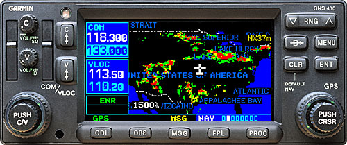

IMHO the ideal used 172 would be an early to mid 70's M model with no damage history, no corrosion, less than 2000TT, recent engine overhaul (less than 5 yrs/500 SMOH), recent paint and interior (less than 5 yrs), and a G430 in the panel. In fact, I have my eye on one just like that (sans G430, but you can buy them used cheap now).

I don't know what a G430 is. What advantages does it have over a yoke mount and some form of hand held that I could take in my Christen Eagle* as well?

G430 is Garmin IFR GPS. Smaller version of G530. Now
obsolete. Prices dropping, esp for non-WAAS version
Has comm, VOR, LOC, GS and IFR GPS for enroute, terminal
and approach. Colour moving map and NA database.
It can be handy to file IFR in a 172, through a cloud layer.
However, for bang for the buck for VFR-only ops, get a
portable GPS with a gizmo docking station in the panel:
http://www.airgizmos.com/Panel-Docks_c_1.html

Ooooo, it gots a com in it. That could replace a clunky 1956 Cessna radio and shave some pounds I suspect. I love it when I get unexpected bonus lurnin' in a thread.

G430 isnt obsolete. The G430W is still in production and is a garmin supported product and the non WAAS version can be sent to Garmin fro a waas upgrade. Still a good unit and quite common in a lot of A/C, 100 000 installed by 2009 (whole GNS family)

What are the prices like on those units?

I didn't know you could upgrade a G430 to a G430W simply
by sending it to Garmin. Hmmm.
Anyways, my ideal panel for a single or light twin which is
flown mostly VFR but occasionally IFR would be:
PM 1000 ICS (new - save $1000 on audio panel)
G430 comm/vor/loc/gs/ifr gps (used, but do IFR paperwork)
G320A transponder & ACK blind encoder (new)
No HSI, no autopilot, no stormscope. Use a battery-powered
VFR portable GPS as backup in case everything goes black. Get
XM wx if you want.

9 or ten thousand, maybe the same to install. 400 dollars a year for annual subscription for database updates

Yeah they will upgrade it all you have to do on the aircraft is change the antenna (same bolt pattern and same connector, easy) and a bit of wiring that may take a couple hours.
Colonel Sanders wrote:Anyways, my ideal panel for a single or light twin which isflown mostly VFR but occasionally IFR would be:PM 1000 ICS (new - save $1000 on audio panel)G430 comm/vor/loc/gs/ifr gps (used, but do IFR paperwork)G320A transponder & ACK blind encoder (new)
Youre still missing a second Comm and second Nav...
