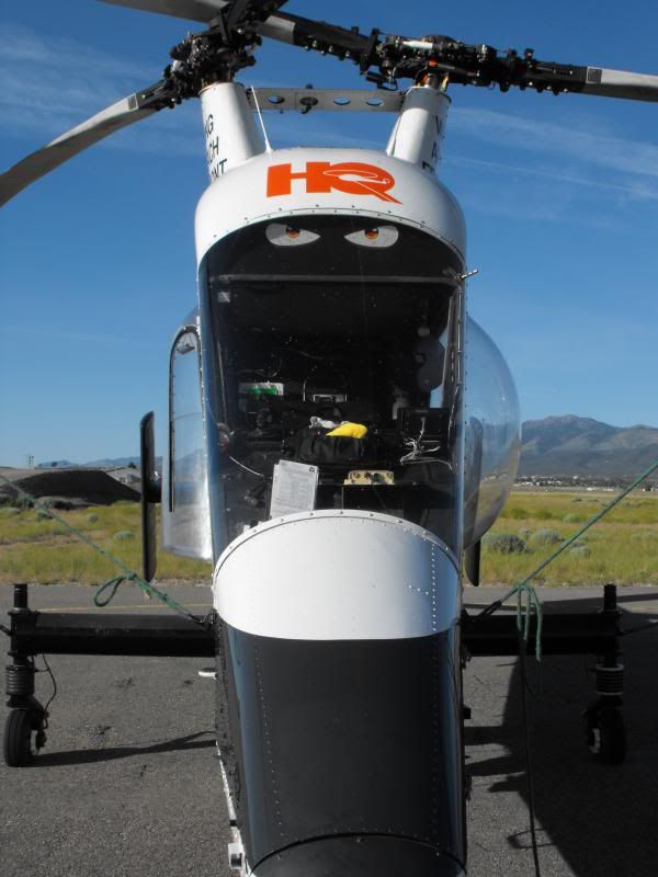

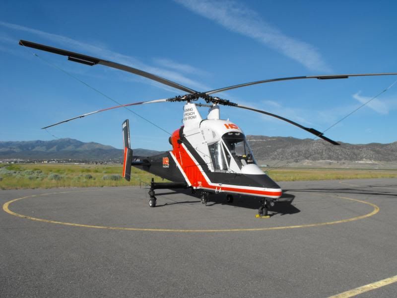

Saw this guy parked at a place I was passing by. Neat machine. I can't get over watching it fly. Wish I would have had my video camera at the ready when I saw him later working along a ridge.

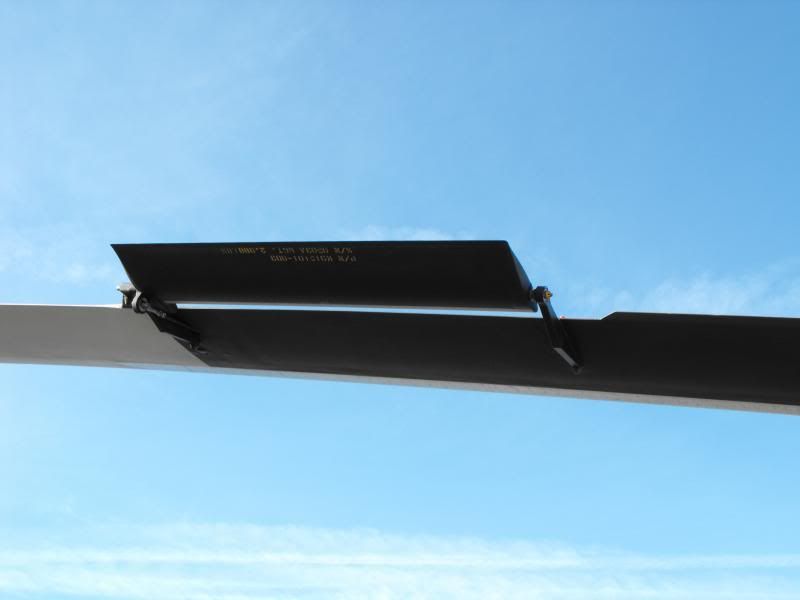

Interesting. I've seen them before but never noticed the 'bladerons'.

Blade-erons? Is that a rigid rotor?

No translating tendencies, because there is no tail rotor and the masts are at opposing angles so they cancel each other out. In a hover, blade angles should be nearly equal.
Dissymmetry of lift is the same as any helicopter, as is retreating blade stall. The rotors don't know if the are horizontal or angled--look at a tail rotor and how it deals with the same. The only difference is is localized disturbances from the other rotor, which is why--I imagine--they put the retreating blades outboard.

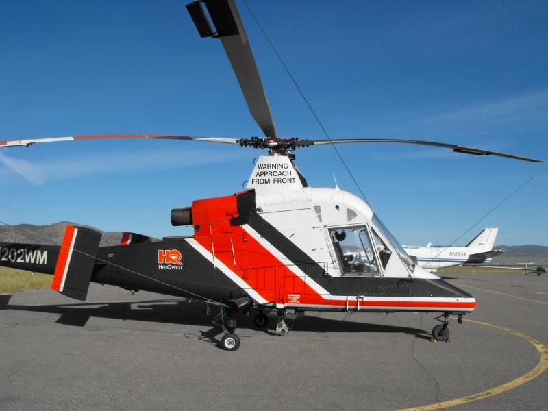

Definitely a fully-articulated head; look at the blades relative to each other in the middle photo... lead lag hinges. According to Wikipedia, they have wooden spars too.....

The "bladerons" is what gives your pitch angle on the blades. This aircraft was specifically built for external load operations.
