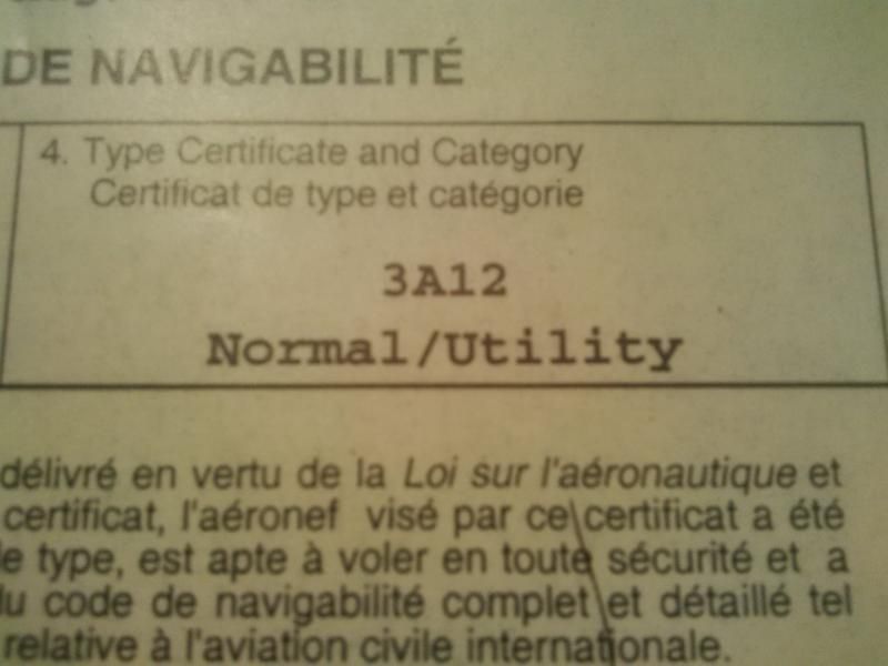

Shiny Side Up
Posts: 5335
Location: Group W bench
Re: Normal or Utility Category
Post by Shiny Side Up »
photofly wrote:I don't believe any C172 has "utility" on the C of A. In a sample of 4 of various vintages, all say "normal".
Prepare to be blown away!
Actually that's usually how most of the newer CoAs look, the old ones (like the one for a '59) say "standard".

PilotDAR wrote:The "Normal" of registry is a different "normal" than that of the certification - just to confuse you. A Normal registry aircraft is not "special purpose". "Agricultural" etc. This is unrelated to the Normal vs Utility of design certification, so, an aircraft eligible in both Normal and Utility, like the 172, may go back and forth form N to U, (even within the flight, if well planned), without any change to anything, unless, as said, a mod on the aircraft removes spinning privilege.
Hmm, I thought the C of A had categories like "Normal", "Utility", "Aerobatic", "Commuter". As spelled out here or so.
chephy
Posts: 63
Joined: Wed Jul 23, 2008 9:44 pm
Post by chephy »
Shiny Side Up wrote:Prepare to be blown away!
Jeez... So... would it be illegal to spin a 172 that just said "Normal"??
I'd ask Transport, but in my experience they take between about 2 and infinity months to get back to you... and then they usually give an answer that would provide them with the most ass coverage in case they misunderstood their own regs, not the answer that's actually true.
I regularly spin 4 172s, all of which (I checked again today) say "Normal" on the C of A.
I don't think 172's can read.
photofly wrote:I regularly spin 4 172s, all of which (I checked again today) say "Normal" on the C of A.
No, but TC can. Which would be interesting if you log the the spin exercises in the PTRs and they find out they are done in a "Normal" only airplane.
Ours shows Normal / Utility as well by the way.
